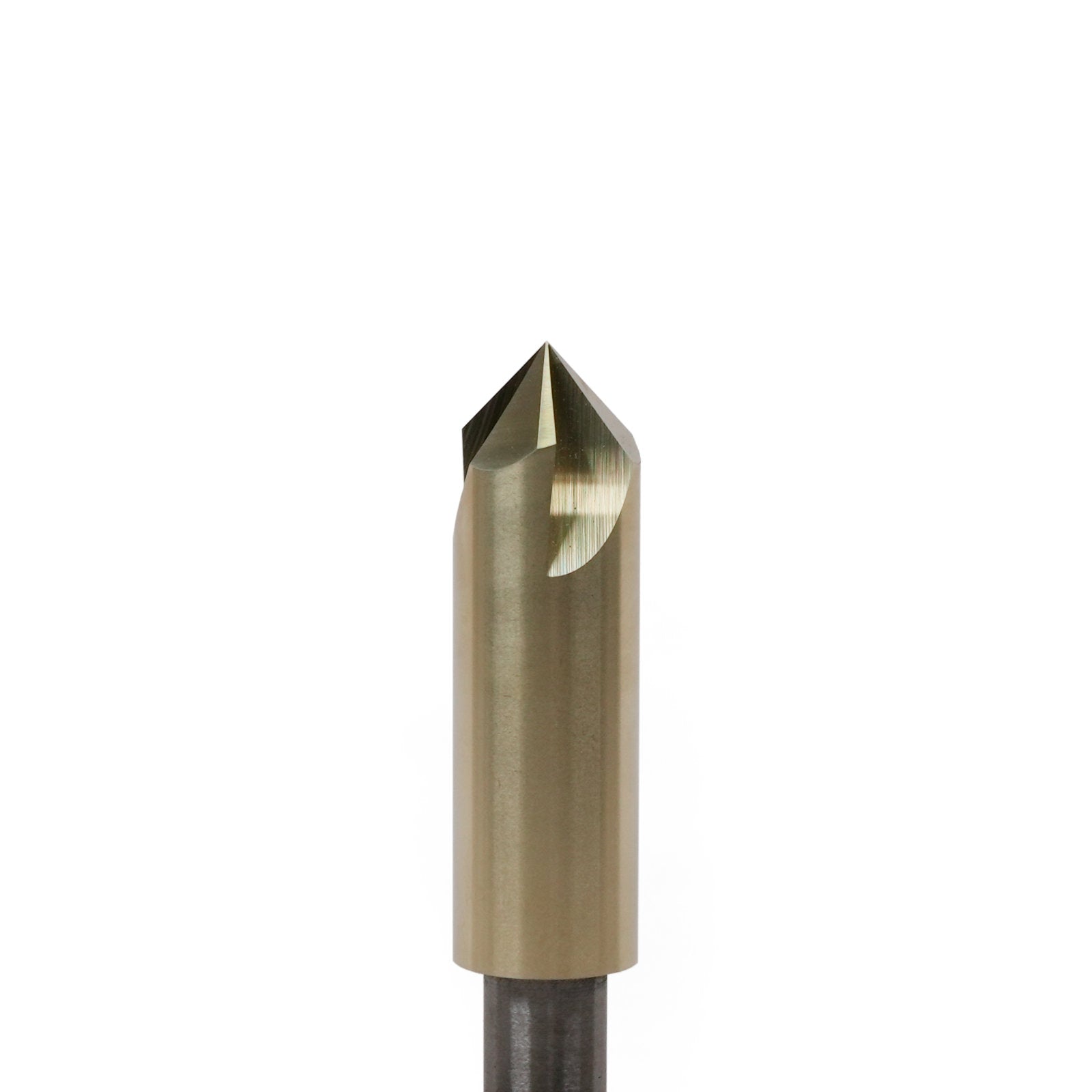

The #311 90 degree solid Vee cutter is part of our "El Ocho" series of cutters with an 8mm shank.
Materials to Cut: Wood
Applications: Engraving V-Carving Woodworking
Specifications
Inch Metric
Shape V-bit
Shank Diameter
Flute Diameter
Corner Radius
Overall Length
Taper Angle 45 degrees
Included Angle 90 degrees
Number of Flutes 3
Material Solid Carbide
Coating ZrN
Why Use These Cutters?
We designed our El Ocho series of cutters to be a good compromise between strength from the larger diameter, while still being small enough to cut smaller features. The 8mm shank is small enough to fit into all ER-11, ER-16, and ER-20 spindles.
