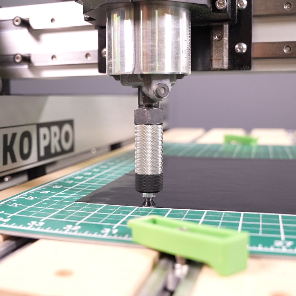

The Stingray Vinyl Cutter allows you to cut adhesive vinyl sheets, and other thin material, on your Shapeoko CNC Router.
Watch the video below to learn more and see the Stingray in action...

  • 1/4" shaft, allowing it to mount in your existing spindle or router.
  • Adjustable depth of cut.

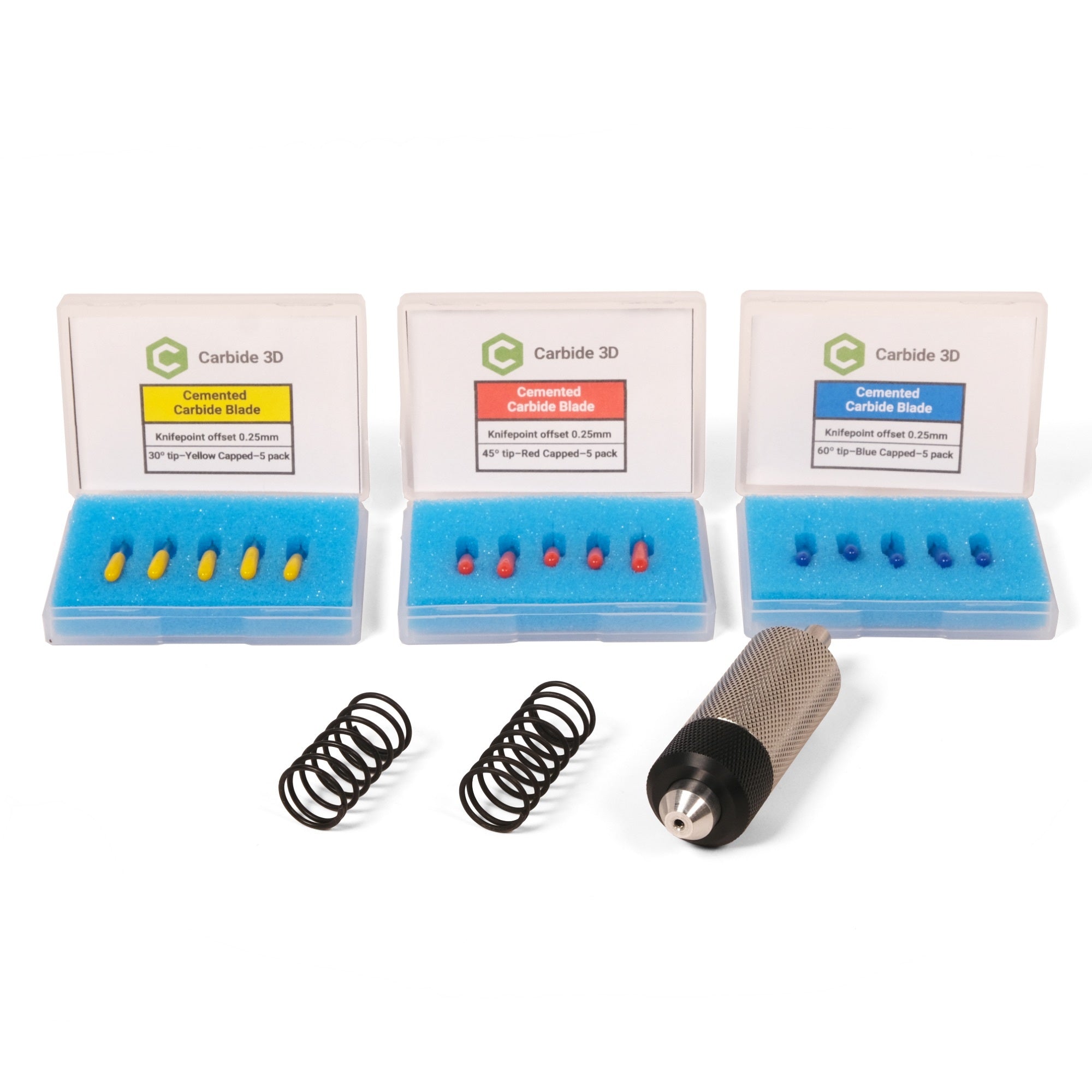

  • Stingray
  • 3 Springs with different force levels
  • Qty 5, 25-degree blade
  • Qty 5, 45-degree blade
  • Qty 5, 65-degree blade

Blades
Stingray uses standard blades made for Cricut and Silhouette machines. These blades are available in craft stores or online.
