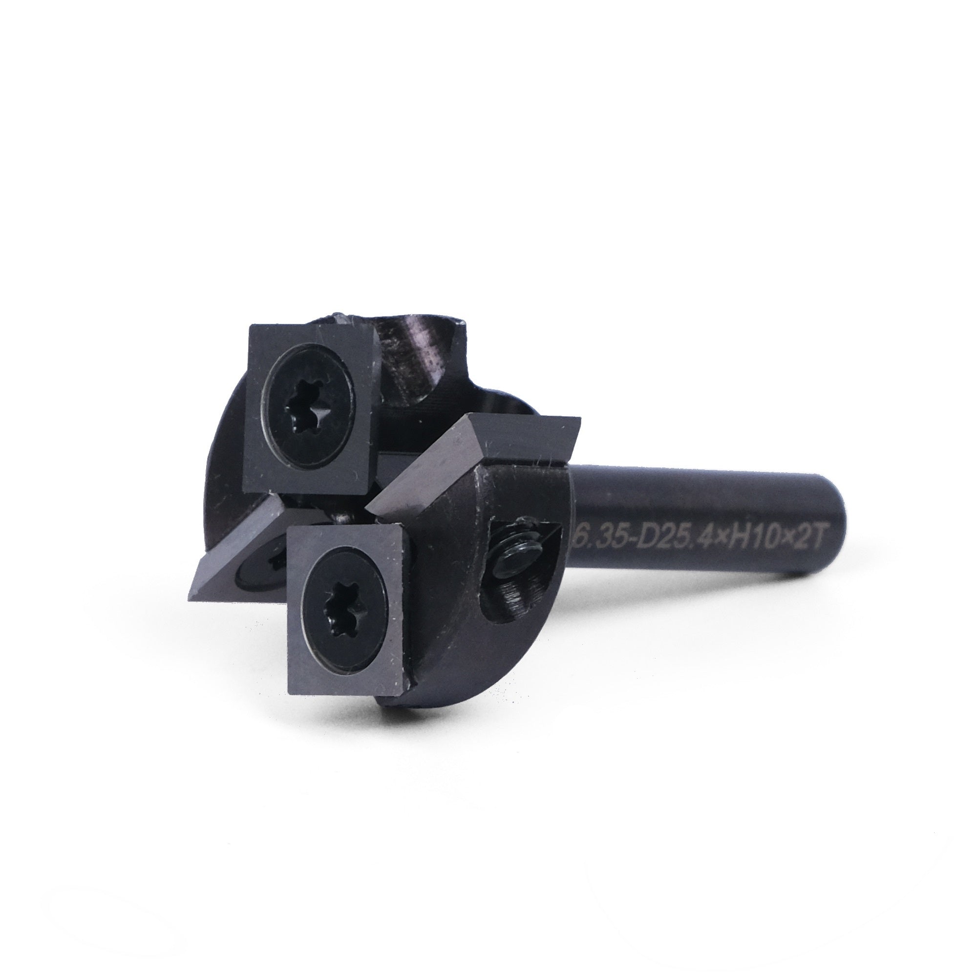

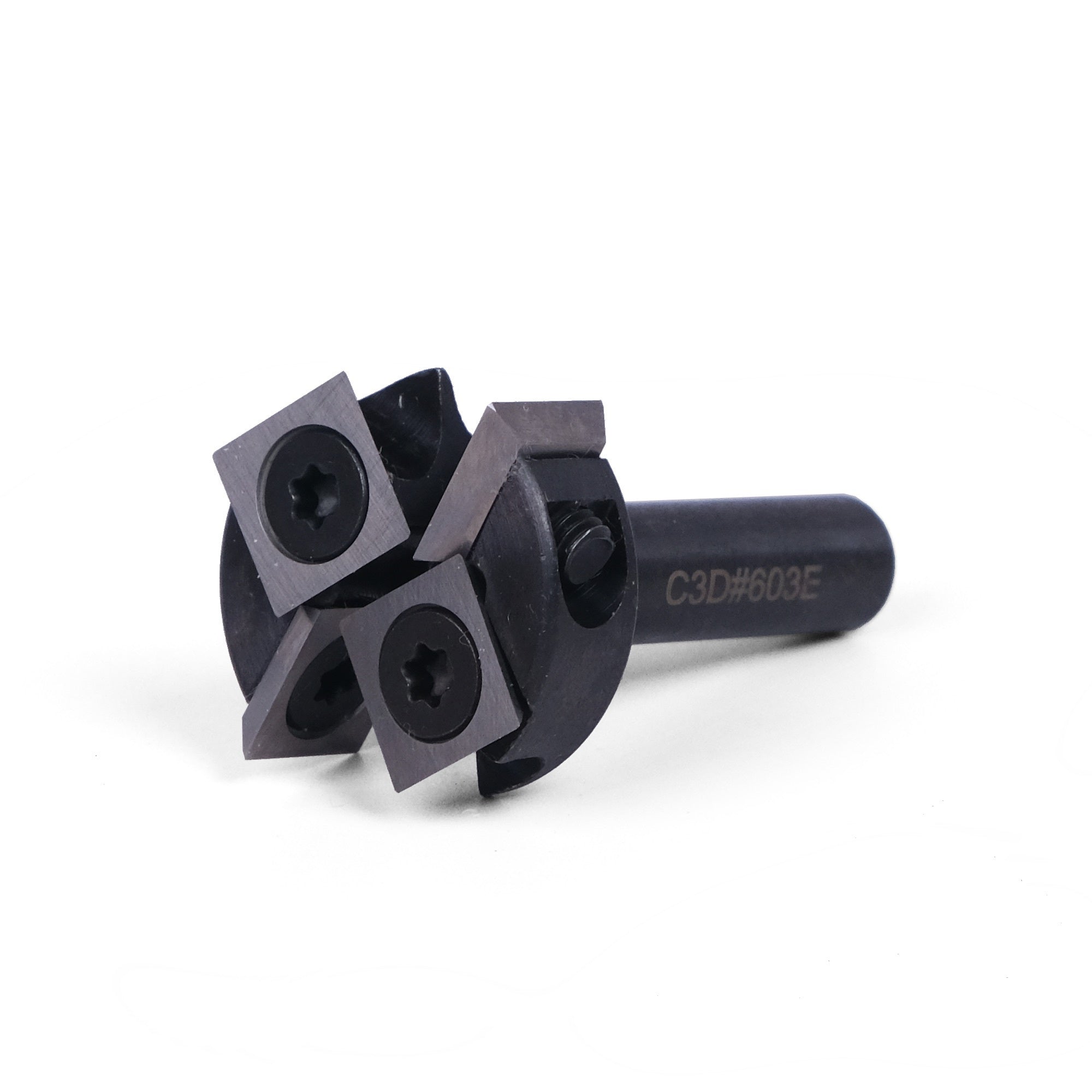

The Carbide 3D McFly Cutter will make light work of any lumber thrown at it.
The razor-sharp, indexable carbide tips are perfect for surfacing your wasteboard or finishing up that beautiful end grain cutting board you've been working on.
Here are the Specs:
  • Cutting Diameter: 1" (25.4mm)
  • Cutting Length: 0.39" (10mm)
  • Shank Diameter: 1/4" (suitable for all Carbide 3D routers and spindles)
What's Included:
  • McFly cutter with 1/4" shaft

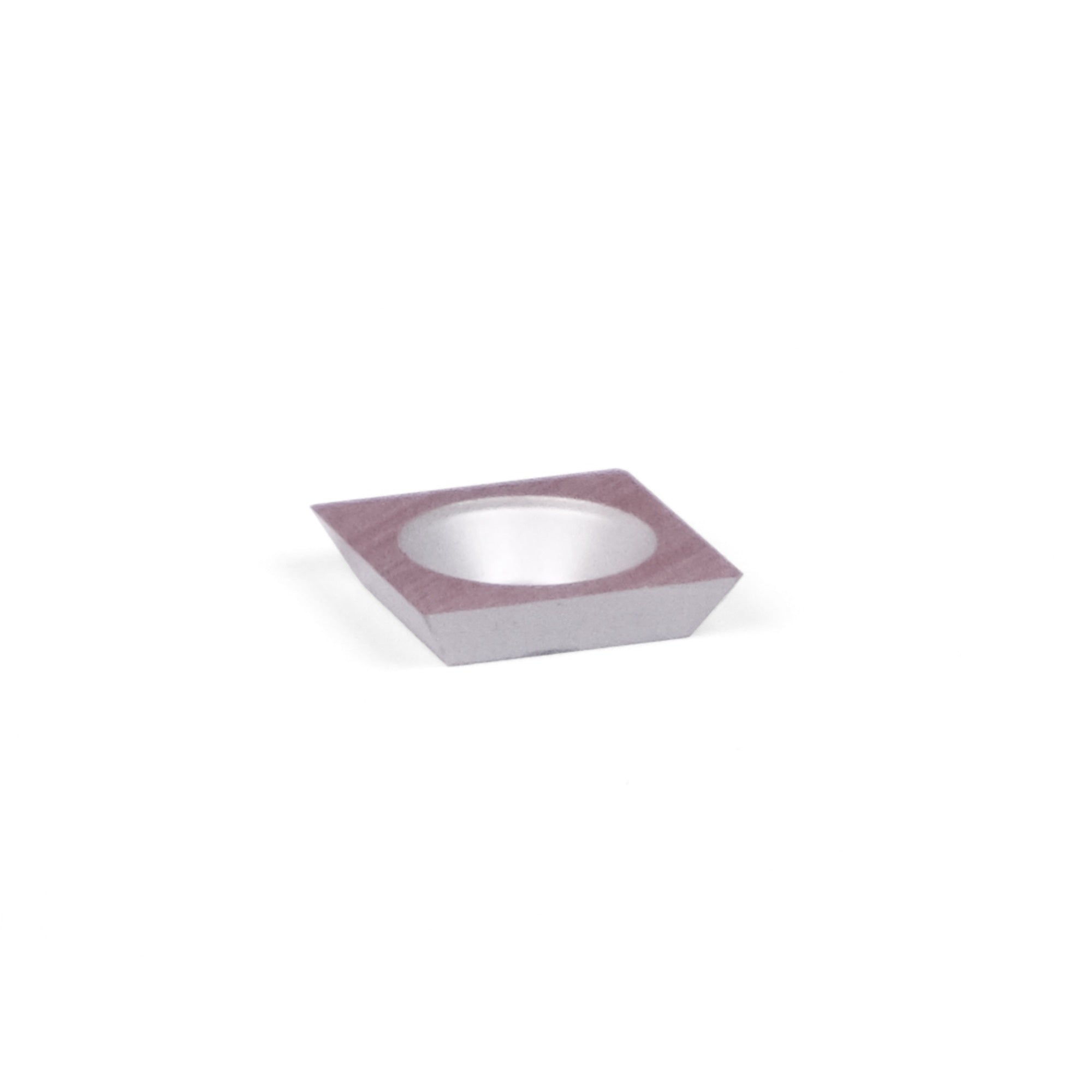

  • 4 Carbide Inserts
Replacement carbide inserts are available separately here.
This tool is designed for wood only, it is not for use on metals. It is only recommended for Shapeoko machines, not Nomads.
Recommended Speeds and Feeds:
  • Depth per pass: 0.02"
  • RPM: 16,000
  • Feedrate: 60 in/min
