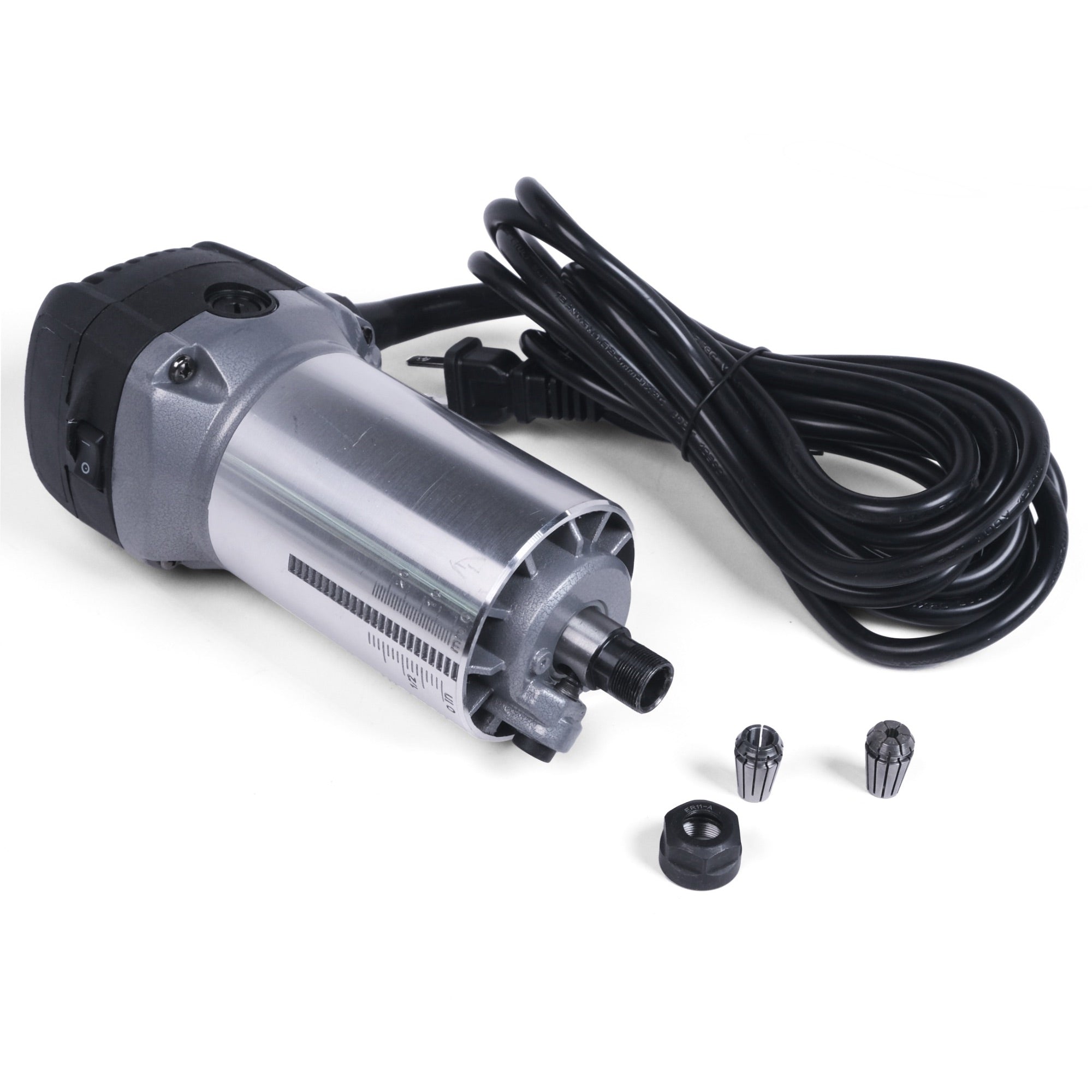

The Carbide ER-11 Compact Router is our custom-made trim router packaged for use with any of our CNC routers. We worked with our router manufacturer for a year to develop this router for us.
Why buy an ER-11 router?

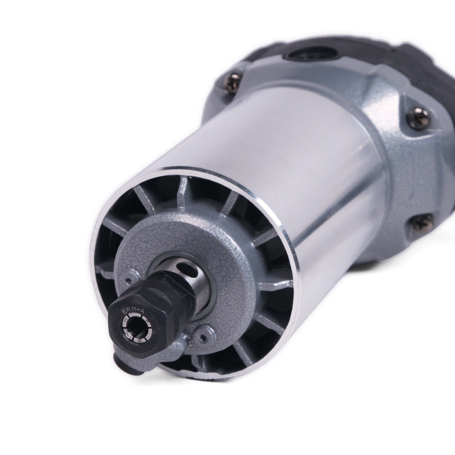

There's only one reason to buy this router over the less expensive Carbide Compact Router: you need to use cutters or drills with a shank diameter other than 1/8" and 1/4". Other than the collets, there is no difference.
The ER-11 Compact Router was made for use in CNC machines so we skip all of the bases and jigs that won't be used anyway. It includes:
- ER-11 Carbide Compact Router
- Collet wrench
- .25" ER-11 collet
- .125" ER-11 collet
- ER-11 Collet nut
- The ER-11 Compact Router includes a 12-foot power cord to make wiring easier for on our Shapeoko CNC Routers

Can I use the precision collets with the ER-11 Compact Router?
No, the precision collets are not compatible with the ER-11 Compact Router. The ER-11 Compact Router uses standard ER-11 collets.
